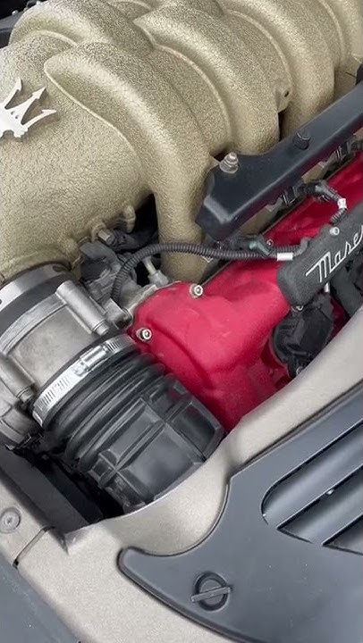

thoughts on the sound of my cold start? Not sure if it’s just the fuel injectors ticking and the normal camshaft noises. Thinking of doing the cam cap job soon DIY.
That is variator rattle for sure on startup...Just doing the caps isn't the entire job and will be hit or miss...J
Different deal...That is a dry sump engine and they often sound like that and it really doesn't get worse so that is about normal...Yours is gonna get worse and get louder and louder and last longer....Jason
