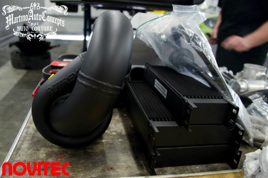

I'm also looking at the feasibility of mounting a centrifugal SC. Here's all I could find searching the net, indeed, the Novitec people are rather good at keeping things under wraps.
On the teamspeed forum there are a couple pics of kit lying out prior to installation, the most valuable photo in my opinion was this one (below), giving some idea of the mounting position and orientation of the supercharger.
https://www.maseratilife.com/forums/attachment.php?attachmentid=120987&thumb=1
I was at first rather confused, using intake side/air filter side as reference the main body of the supercharger would have to remain medial (towards block) to that of the serpentine belt. It finally clicked when I viewed the accessory positions, and in particular the water pump of the 4.2 engine, compared to that of the 4.7. On the 4.2, the water pump is mounted lower and therefore offers a nice niche between the head and water pump on the passenger bank -- I believe this to to be the location of mounting for the Novitec system. Unfortunately we do not have this space on the 4.7, and I can only see the possibility of have the body of the SC facing out, filling the large area currently populated with the large air filter box, and beneath the strut tower brace/connector.

Thanks for the PIC, I am confident that my Gt500 shop can set up a custom kit ( supercharger or turbo modified mustang kit 7-10 Lbs of boost), I would rather do a supercharger. As for fuel with some injectors and a Boost a pump should be ok. The issue is the tuning, do you guys know of anyone who would be able to custom tune it? Is it the same coding as a Ferrari? The tune is the key. Everything else can be done in my opinon.
