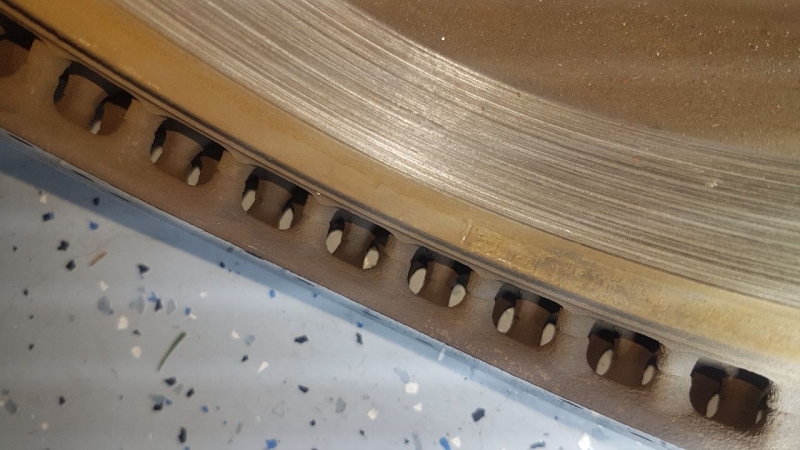

The cross-drilling however is not quite so smart. The first problem is that the cross-drilling isn't chamfered, which significantly increases the rates of cracking and blocking which entirely defeats the intended goal of cross drilling which is ventilation. Cross drilling is a source for corrosion shortening the life of the rotors, and our rotors have all the cross-drilled holes in the same arc which shortens pad life which roughens the pad surface which in turn shortens the rotor life! And believe it or not, cross-drilled rotors exhibit poorer cooling than flat discs because there is less interface surface between the pad and the rotor anyway. So why do cross-drilled rotors even exist? I'll let DBA answer that...
66313
They look cool, that is why.
If you have a look on their website, and that of any large brand you'll find they all have disclaimers saying cross-drilled rotors are not recommended for high temperature applications. You'll never see it in racing as they're a failure risk. And before anyone says it - yes ceramic rotors are cross-drilled, but those material properties are very different to steel and that is a lesson for another day.
So this is the long way of saying that our rotors are fine for daily use but a liability if you like to do track days. Below is a very loose model of rotor temperatures over time for our car on a track day. The two other curves are a low powered lightweight car, and a high powered lightweight car:

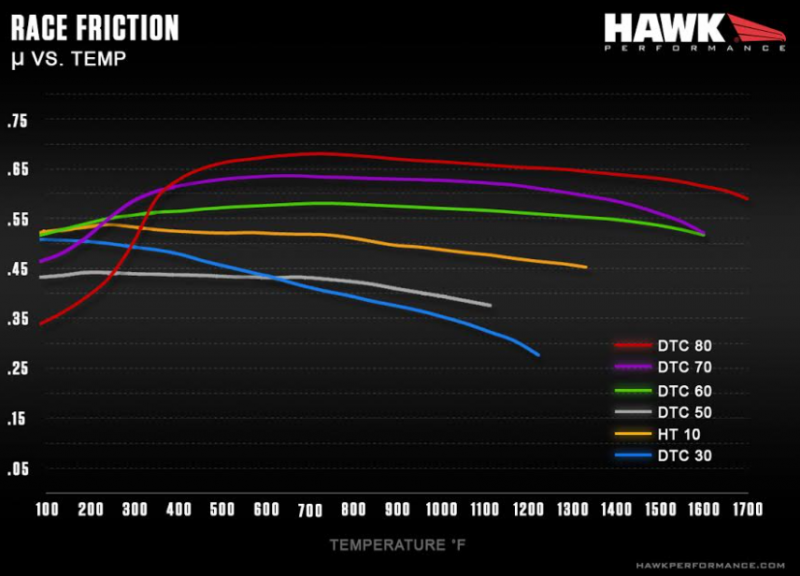

I've been speaking with Hawk and they're going to provide me with updated pad curves Premium Brake Pads, Rotors, & Brake Kits | Hawk Performance

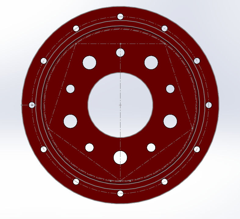

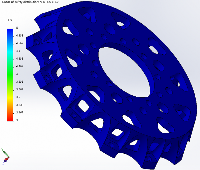

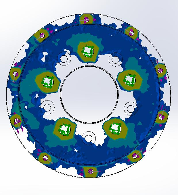

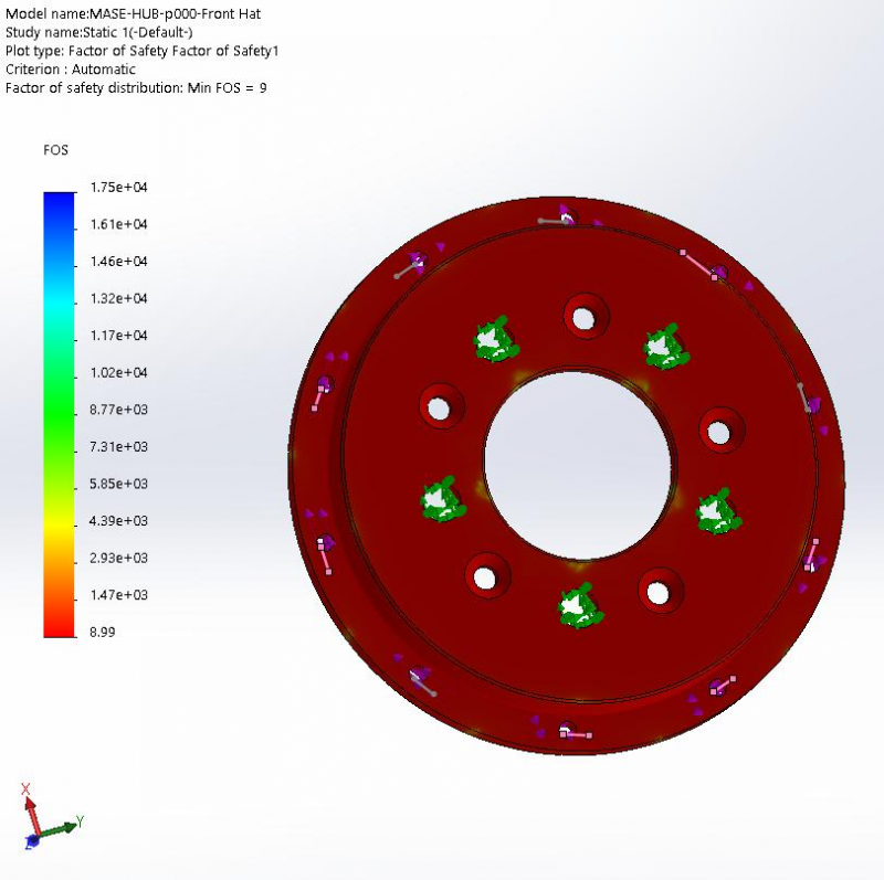

I was a bit curious as to how strong brake hats really are, so I applied a basic model made of 6061-T6 (This is what Wilwood and DBA make their hats out of) and applied some forces and had a look at what happened.
Below the image has the PCD as fixtures and the rotor PCD as a force in a tangent direction to simulate braking. I went nuts and each of the 10 mounting holes is 1kN, so 10kN all up - about 10T per wheel is applied, with a minimum Factor of Safety of 9. So roughly 90T of braking force would be required to fail the hats... ****... Its not quite so simple as there are rotations involved, but a 1.8T car, so 900kg a side (so lets round up to 1T), so you'd need to stopping at something like 90g to break the hats... I'll try and work it out properly in the morning...
71284

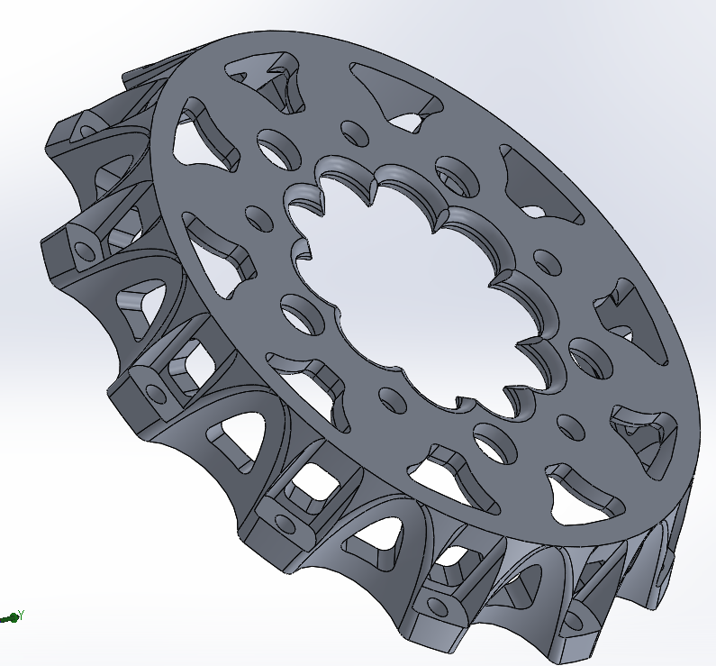

I also did a low effort topology study out of curiosity using 7075-T6, and got the mass down to 400g.
71286

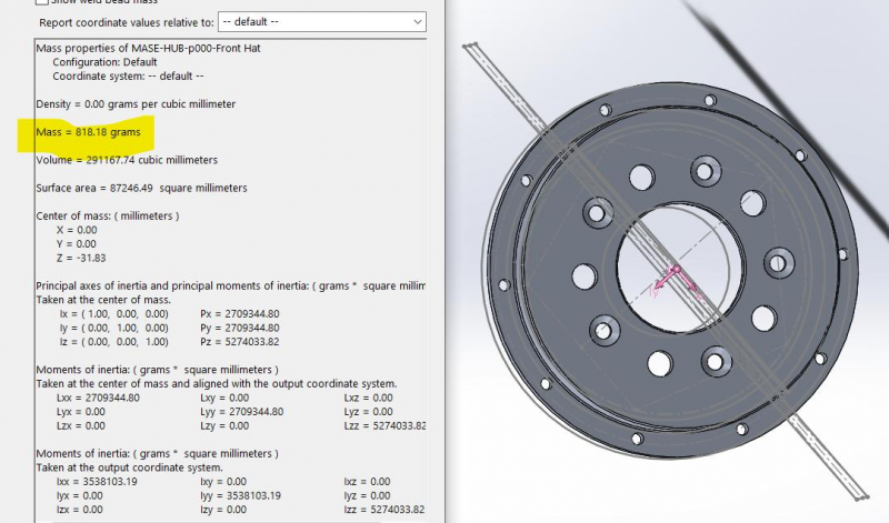

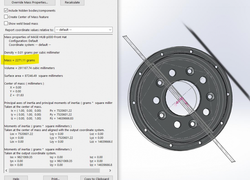

One of the good things about doing things like this as a hobby is that simple economics of production aren't quite the same level of concern. So instead of just making a mounting hat that can be turned out on a lathe of completed on a mill, I decided to unnecessarily optimise my the mass using the topology study I did earlier and some realising values.
71338
71339
I calculated the loads properly this time:
An F1 can slow down at 5g, so I used that as my starting point.
So for my car I rounded up to 2T, and then split that between the two front wheels assuming 100% of the braking force per wheel., so 1T=10kN per wheel.
That means that to slow down at 5g, each wheel experiences 50kN.
Using the rolling diameter of 0.6m the torque applied (and assuming zero slip) at each wheel is 30kNm.
At the 108mm PCD the force applied is now 3/0.108 = 280kN. I applied this across the 5 bolts, so 56kN at each bolt. I then fixed the rotor PCD so that the whole thing would be getting twisted as if the rotor is stationary and the force is being applied without any slip.
Using the scenario of a two wheel, 2T formula one car slowing down at 5g these hubs have a minimum factor safety of 1. So with a more realistic expectation of ~1g each hub has a FOS >5.
It also weighs in at 645g.
With the rotor I've selected, if the hub were steel the total mass would be ~10.8kg. With the aluminium hats, the total mass is lower than OEM at ~9kg. Due to the large rotor I've selected, the thermal mass is higher than OEM but the total mass is lower.
Is any of this necessary? No.
Are you likely to feel the difference using an unobtanium alloy saving you an extra 150g from something normal like 6061-T6 (which is used on race cars). Definitely not.
Am I getting them quote in 7075-T651 because I can and I'm doing this for fun and idgaf? Yes, yes I am.

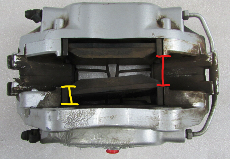

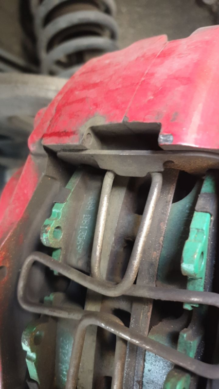

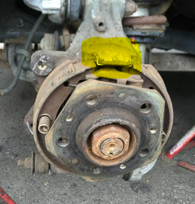

Reviewing my notes just now, there were actually a bunch of issues with the rear rotor, even deleting the handbrake. The front rotor was easy, Wilwood and DBA both have rotors that are a straight fit, even for the unusually large annulus.
If anyone can help confirm/answer the following it would be super helpful:
1 - What is the diameter of the rear rotor? I measured 312mm but that is an incredibly uncommon size. If it is 312mm, then I'll almost certainly need to pick a rotor of a different size, probably 308mm or 316mm, so it would help to have an idea of the rotor/caliper clearance as well (this is the gap between the top of the rotor and anything it will hit inside the caliper if it were bigger). When I inspected the car initially I took some photos and it looks like there may be a bit of clearance to go slightly larger. It is pretty unusual for the pads to run right up on the edge of the rotor which indicates that the rotor may be undersized for the caliper.
71395
2 - The swept area of the pad. Sometimes you can get it from pad drawings, but the pads in my car don't have a detailed enough drawing when I look it up. Knowing this will help me size the annulus of the rotor if required. The easiest way to work .this out is to measure the wear surface on a rotor, since that is where the pad is sweeping! I used a drawing from Hawk to infer the swept area as ~59mm, which is pretty hefty for rear calipers!
3 - Anyone who has changed the rear rotor/pads with any regularity, if you could comment on how snug the fit was? 30mm thick rotors are far more common than 28mm and I'd be far more likely to fit the OEM hand brake if I can squeeze a fatter rotor in. The line in red dictates the maximum fitment the caliper will allow, yellow the maximum pad width. I looked up the part number of the pad that was in there, DB1356SP, which is a pad used on HSV vehicles. Coincidentally it was the pad that would've been specced for the rotor that I've selected for the front! Anyway, the pad is 16.5mm thick when new, which matches with the thickness of the the Porsche 911 (964) pads which also fit.
71396
Everything is odd in the braking setup of this car, I wish I knew what was going on at the time. They're used front calipers as rear calipers that are effectively the same size (functionally) as the front, which leads me to think the only reason they ran a different caliper was cosmetic.... any help would be appreciated.

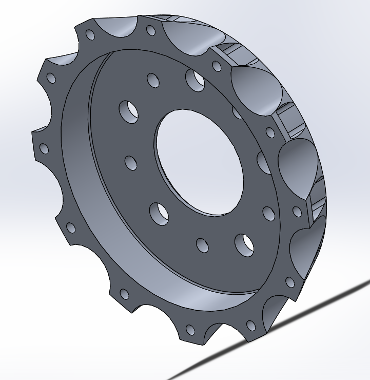

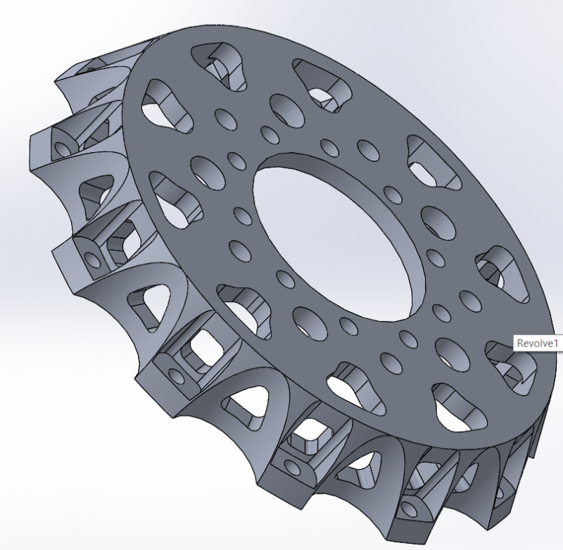

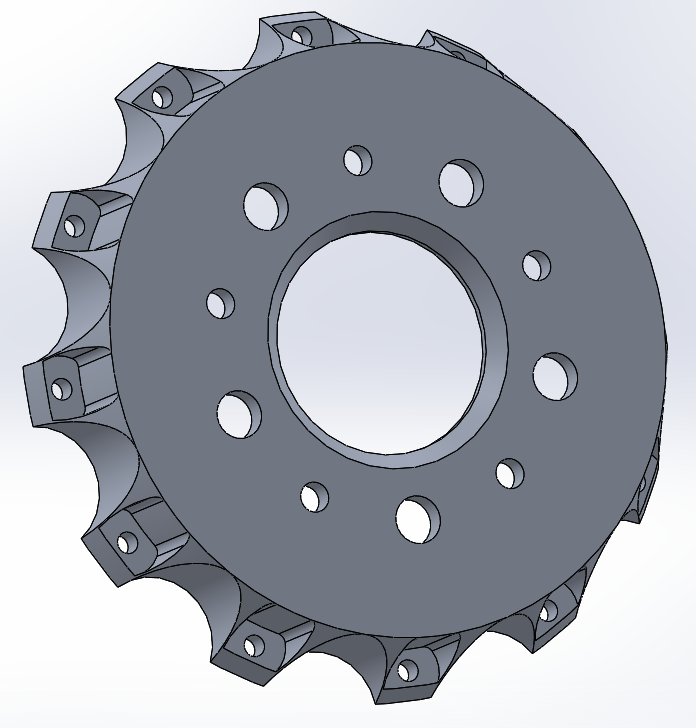

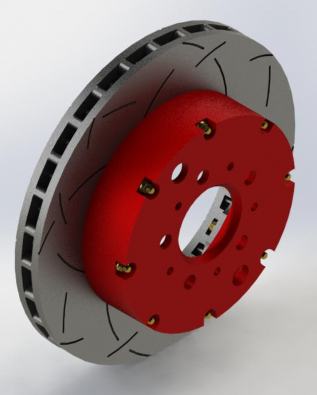

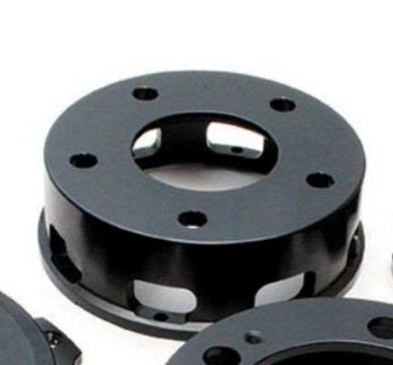

With the front rotor I got my quote back for my ultralight hat - unfortunately infinity dollars is too much, so I dropped back to something more sensible. The below design is pretty much standard fare. The scallops around the mounting points isn't there for weight reduction, but to reduce heat conduction through to the aluminium.
I will be making them out of 6061-T6, this is the same grade that is used by DBA and a bunch of others. It knocks the weight down to 1/3rd compared to steel of the same dimensions and is nearly as strong. The V8 Supercars use this as the material for the hats on their rotors, and I imagine its the same for all touring cars.
I included a screen shot of some off the shelf rotors with hats by DBA for comparison. The chamfered edge towards the mounting holes is significantly stronger than going into a flat edge, and it had a negligible effect on costs, so I'll keep it. One little thing I did that was my own idea was chamfering the centre bore. Whenever a rotor sticks to a hub, its always due to the centre bore. The thing is though, the centre bore is never under any load, so it doesn't need to be a significant structural component. By tapering the edge down it will be much easier to get the rotors on and off in the future.
71493

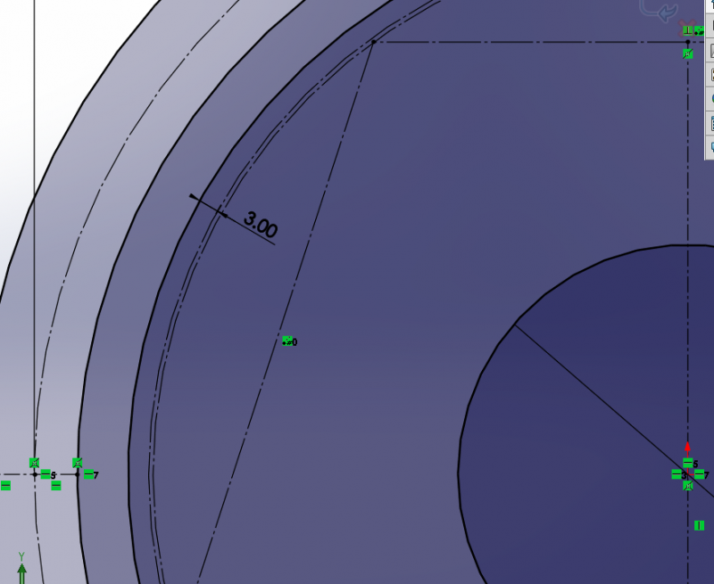

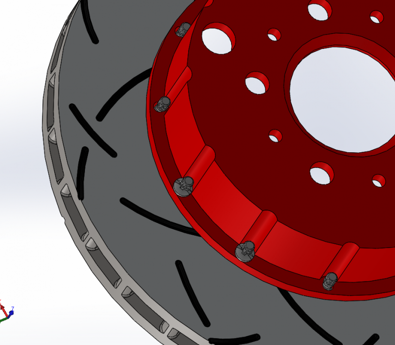

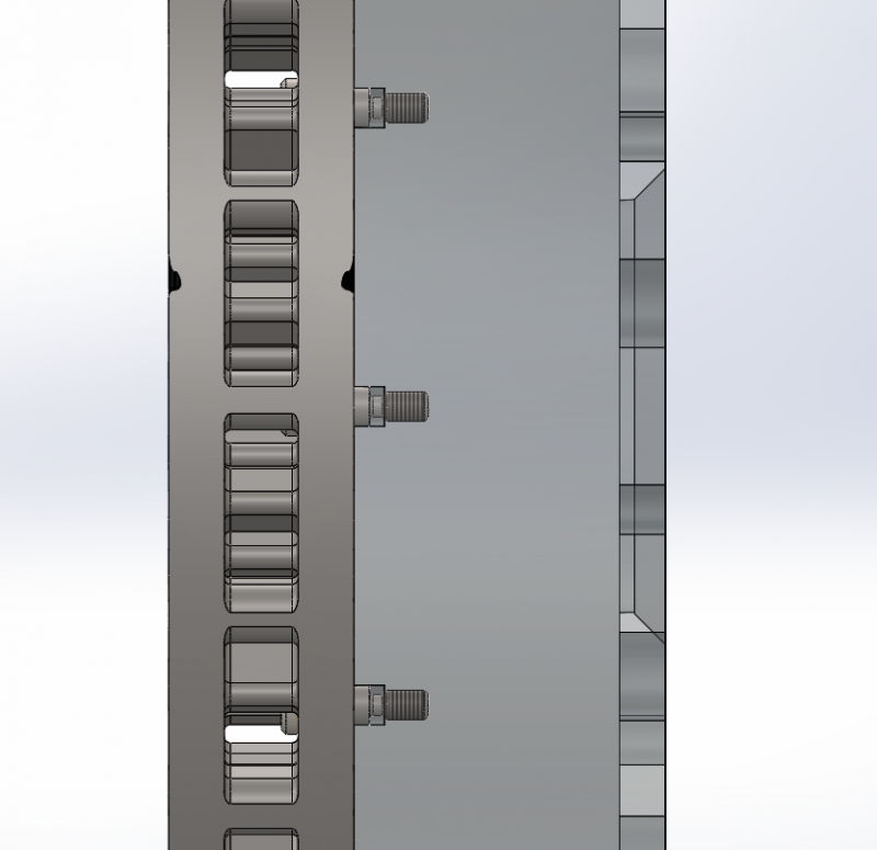

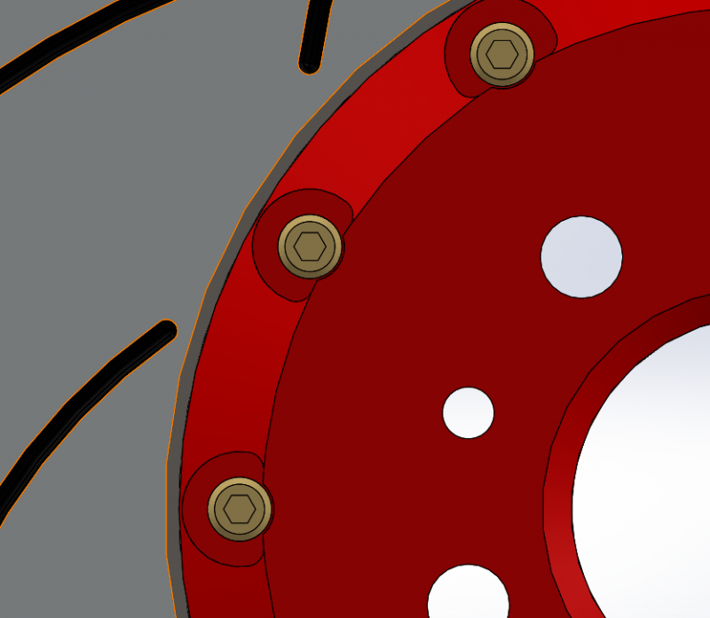

On the inside edge of the hat there is a 3mm fillet (rounded edge) which will prevent stress from focusing in the flat top.
71494
There is a 3mm clearance between the hub and the inside wall. This tiny clearance was one of the most troublesome items. Finding a rotor with a large annulus and a small rotor PCD was very difficult.

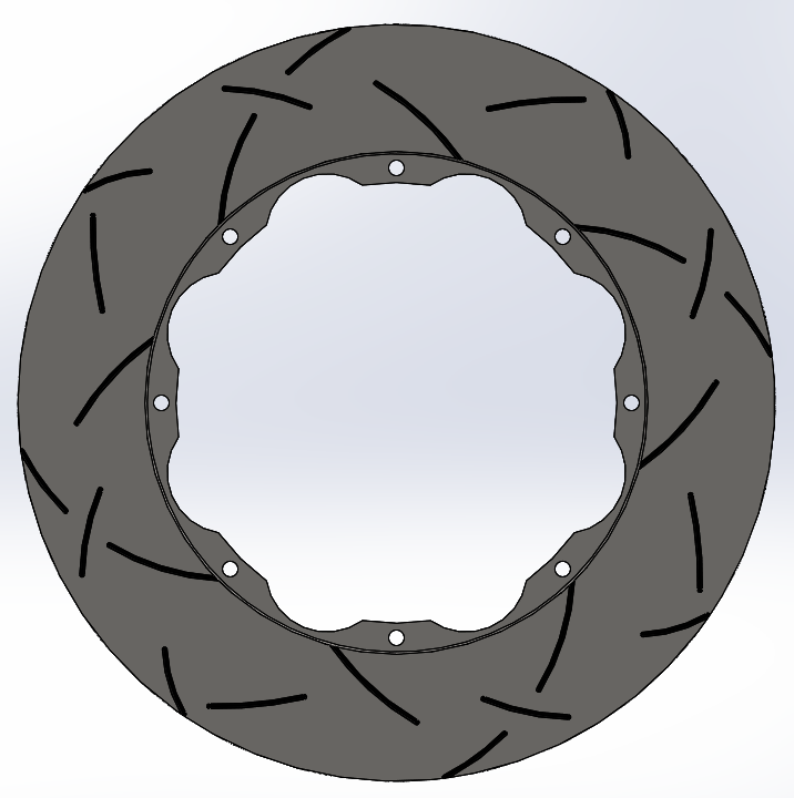

71496
71495

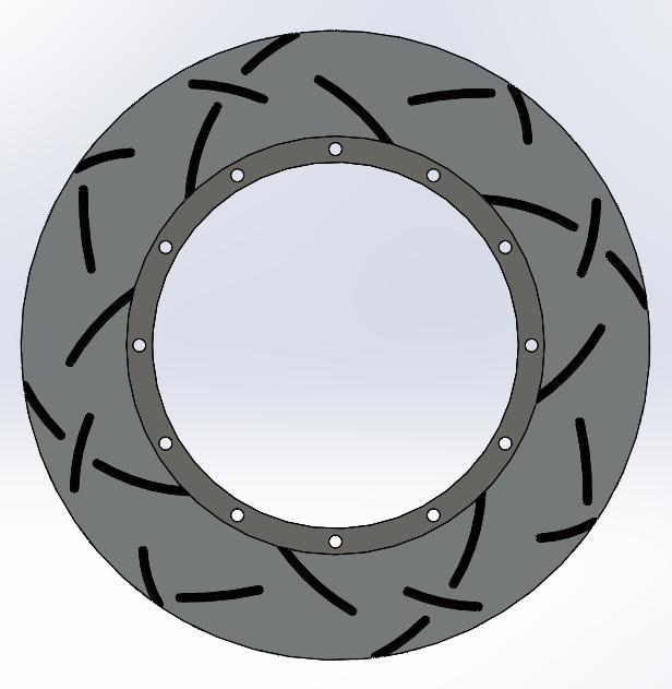

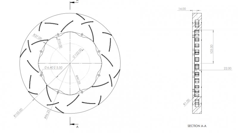

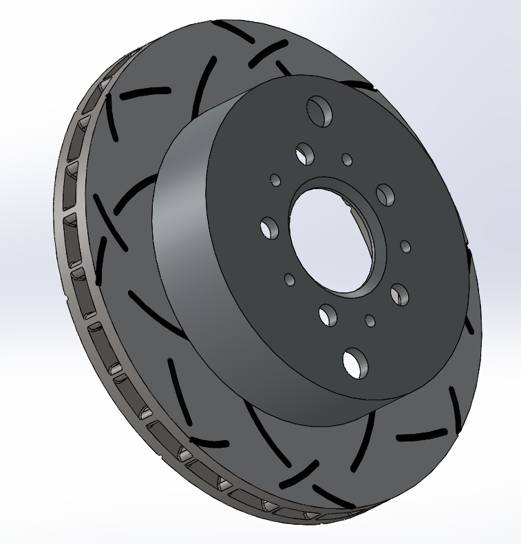

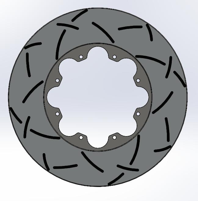

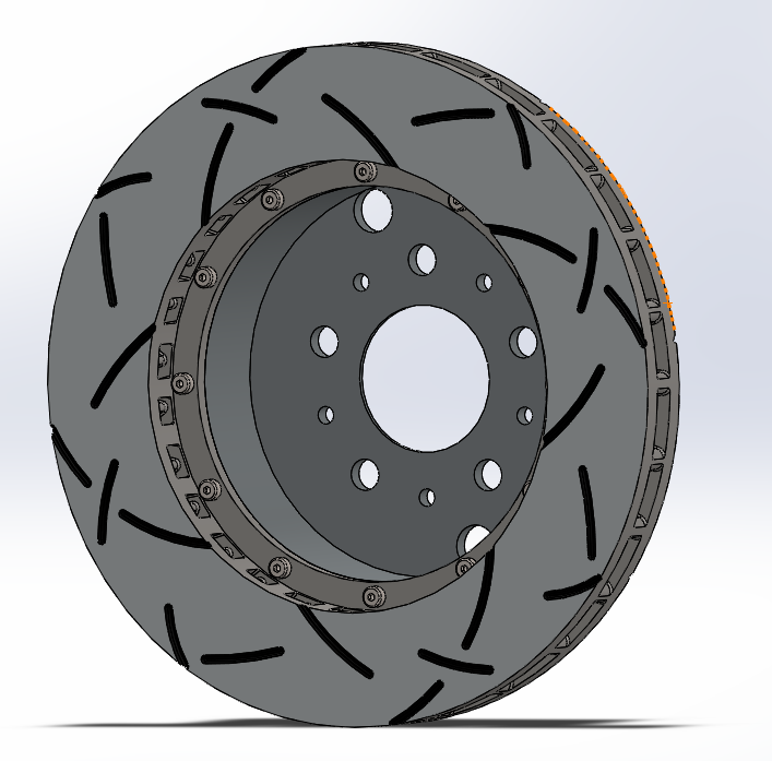

Below is the rotor the hat is designed for. These directional vaned rotors are used locally on a range of HSVs, and I believe they are used on Corvettes in the states.
71490
Due to the unusual requirements of annulus and rotor PCD, I was only able to find two rotors that fitted over our hubs without any compromises. One was this, and the other is a rotor at Wilwood. The high vane count of this rotor allows the rotor to be a bit heavier, so a better thermal mass, than the Wilwood and being available locally made it a much cheaper choice for me as shipping is pretty hefty on slabs of steel.
I contacted Wilwood, Brembo, Alcon, AP, DBA and a couple of smaller players and went through hundreds of pages of catalogues. There are other rotors which could fit without modifying the position of the caliper, but they would introduce other compromises such as needing to run a thinner rotor. If I got the pad placement absolutely perfect I could run a couple of other rotors as well, as the minimum annulus is 57mm, but to go down to exactly 57mm on the rotor I'd need to get the centre point perfect otherwise I risk running the pad over the edge, and since I found a couple of fits that worked it wasn't necessary to be that pedantic.
The rear rotors remain somewhat more problematic. The culprit is the highlighted part of the hub, it dictates that the hat must have an internal diameter of 180mm to clear the part, if you include wall thickness then you've got 190mm used up. Working in radii to make the problem a bit clearer:
Outer radius is 160mm
Take away 55mm for the annulus which leaves us with 105mm spare.
Take away 95mm for the hat and you're left with 10mm to mount the hat.
The rotor PCD must occur between 190mm-200mm. Most rotors (regardless of size) have a mounting PCD ~205mm (this is what made it hard to find the front rotors).
I've only found one rotor that meets the bizarre requirements of a huge annulus and small rotor PCD, but there is a compromise in that it isn't 28mm thick but 25mm. The only other candidate I could find was 32mm thick and just won't fit outright, I would need to machine the rotor face. I mean that is fine to do as that is what people do anyway as rotors wear out but it seems a bit of a waste on a brand new rotor. Instead it is easier to fit a thinner rotor and to shim the pads out to prevent the pistons running out so that is what I'm looking at doing currently. I still need to confirm though if the annulus is 55mm or 50mm as that makes a substantial difference to the rotors I can choose from.

For a bit of fun, this was the final version of the ultra light hat:
71498
71499

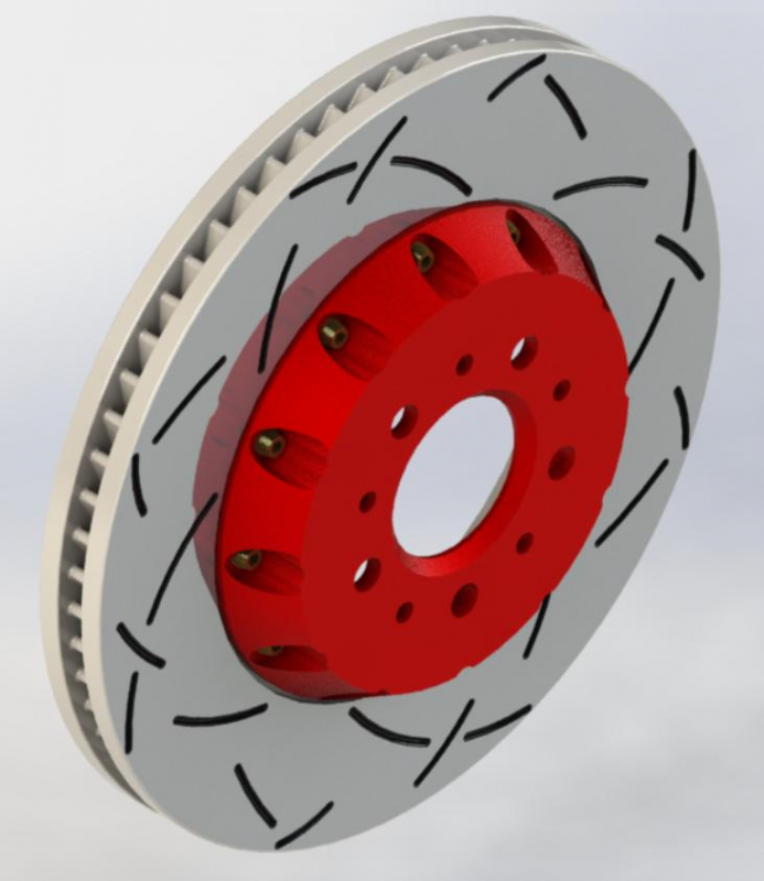

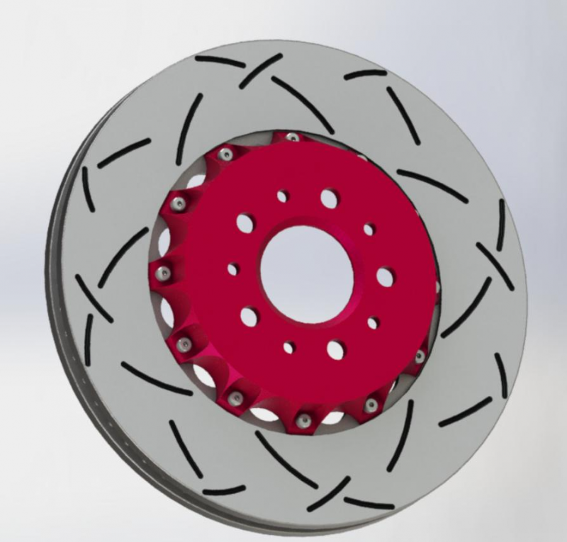

Turns out I can get my rotor hats anodised any colour I want. What colour would you all pick?
71537

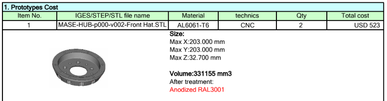

So I have some solid costs now (in AUD):
$288 per front rotor
$334 per rear rotor
$361 per hat (including shipping and finishing)
All up it would be $1578, or about 850GBP. Compared to getting new units from eurospares, it is a little bit more in direct costs as the parts would be $1140, but there would also be around $300 in shipping. So I'll be charitable can say that my bits are $1600 v $1400. If you tried to get the parts through a dealer though.... oof.... Compared to FD, all four would be ~$1600 before shipping for the OEM replacements. I've seen front only kits that are still cross-drilled, or require skinnier pads at between $1200-$1600 for just fronts, before shipping.
Anyway, its looking like its worth my effort, and these rotors will probably last longer than the rest of the car does...
Design wise, everything up front is finished and I just need to step up and press buy. The rears I need to measure a few more things. It would appear that the rear calipers will hold a 30mm wide rotor and if that is the case then I will be able to directly fit a couple of rotors. I also searched through a bunch of pads that would fit, and found a couple a bit thinner which would accommodate the extra 2mm if needed. If I can squeeze a 32mm rotor in then things get a lot better, but I doubt it. If the 30mm thick rotor will fit, DBA52650.1 would be a prime choice to accommodate the OEM handbrake.
I am debating on ordering the front rotors and hats now and resolving the rears later as I can't measure the critical dimensions on the rear till I get home in a few weeks. The other part of me wants to do it all in one go...

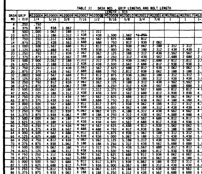

Right now I'm finalising some choices for bolts lengths, and double checking things, but all the big decisions have been made, so I'll run you through it.
Front Rotor

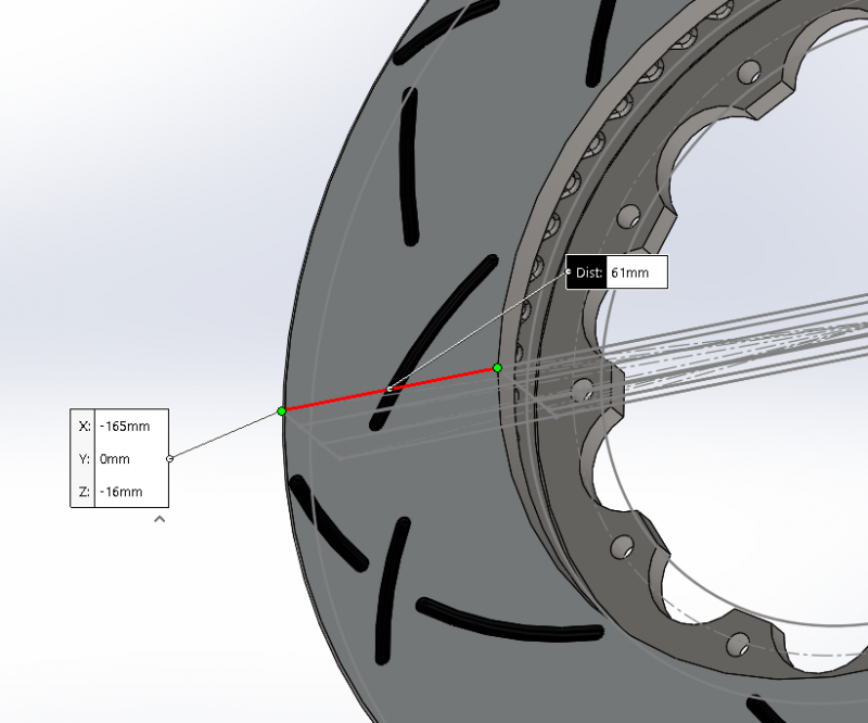

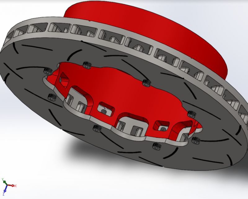

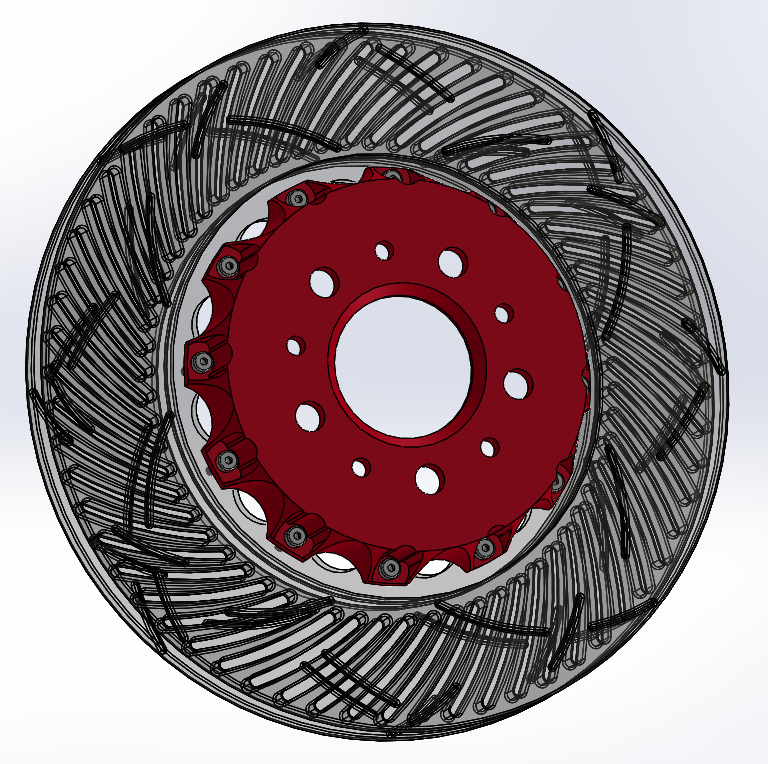

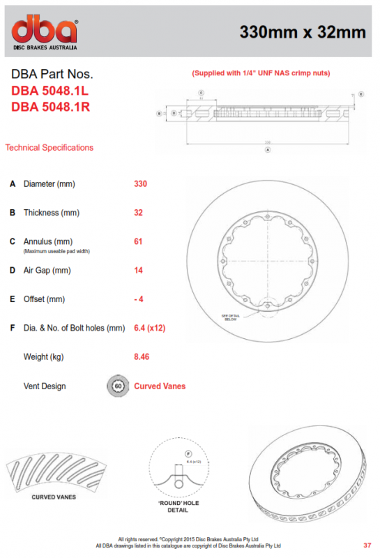

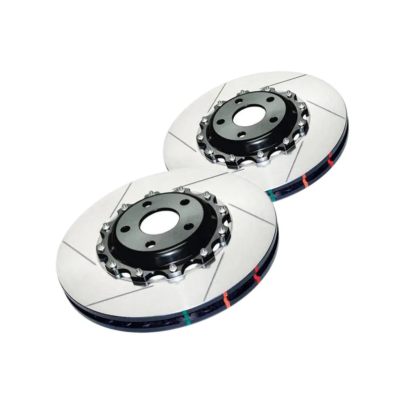

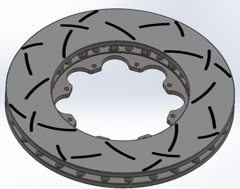

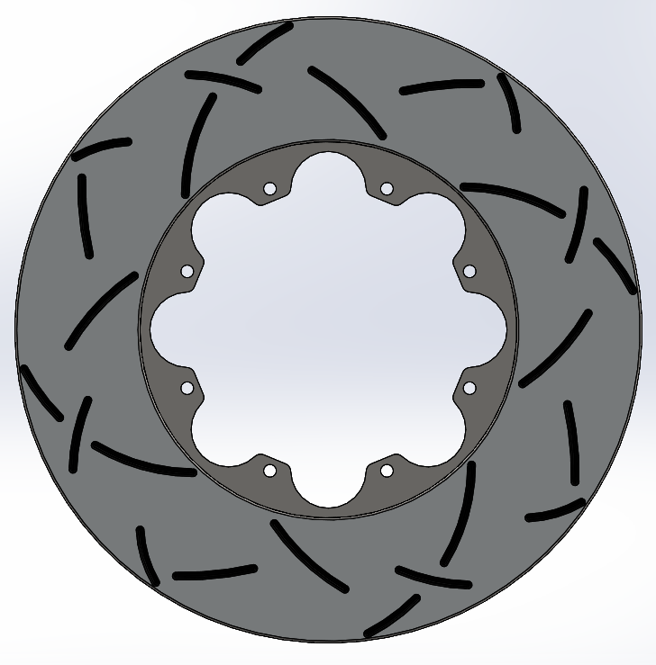

I found two rotors that would fit all the limitations:
Willwood 150-15256 - This rotor meets all the requirements, is a directional vane rotor and hat an 8 hole mounting pattern.
DBA5048.1L/R - Available globally, but most importantly locally for me. It has a 12 hole mounting pattern, which I like as it would distribute the load more. Availability was the main factor here.

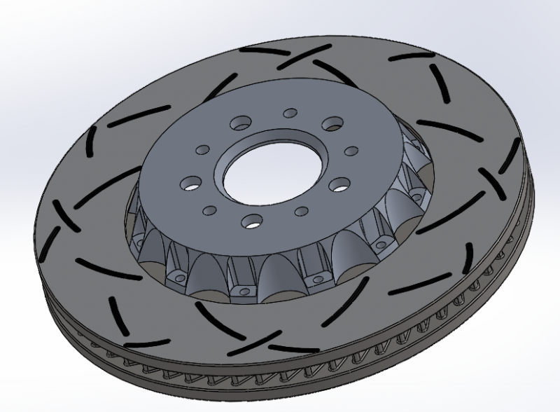

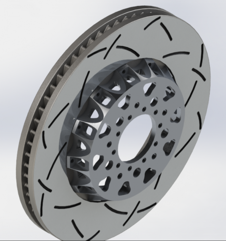

Here is an transparent screen shot of the rotor model:

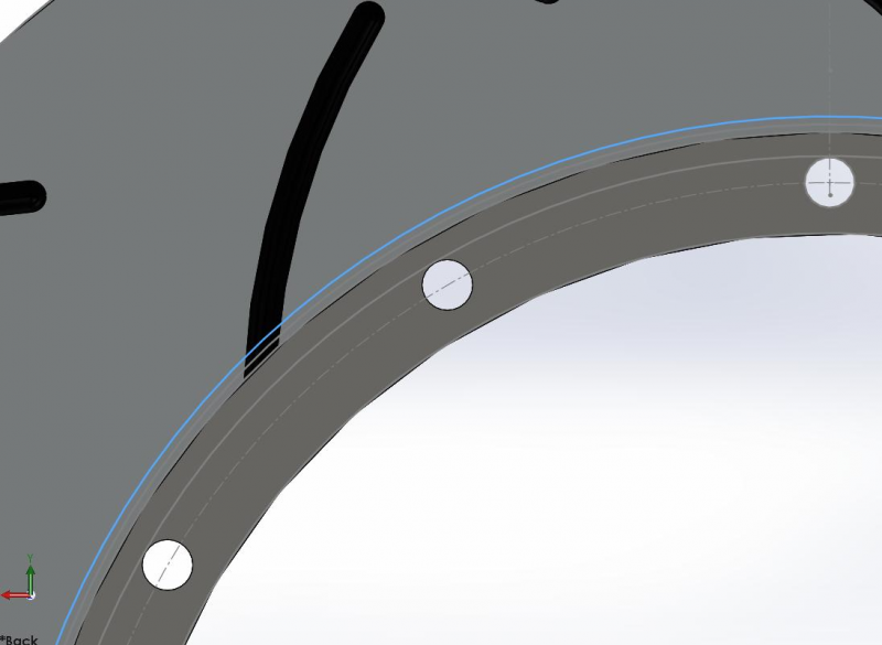

71593
The OEM annulus is 61mm, and since I measured the area swept by the pad as 57mm there is plenty of area for the pad:

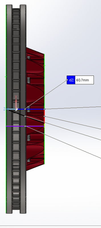

71594
Total height of the rotor and hat is the OEM spec is 60.7mm to ensure it fits with the factory calipers:
71595

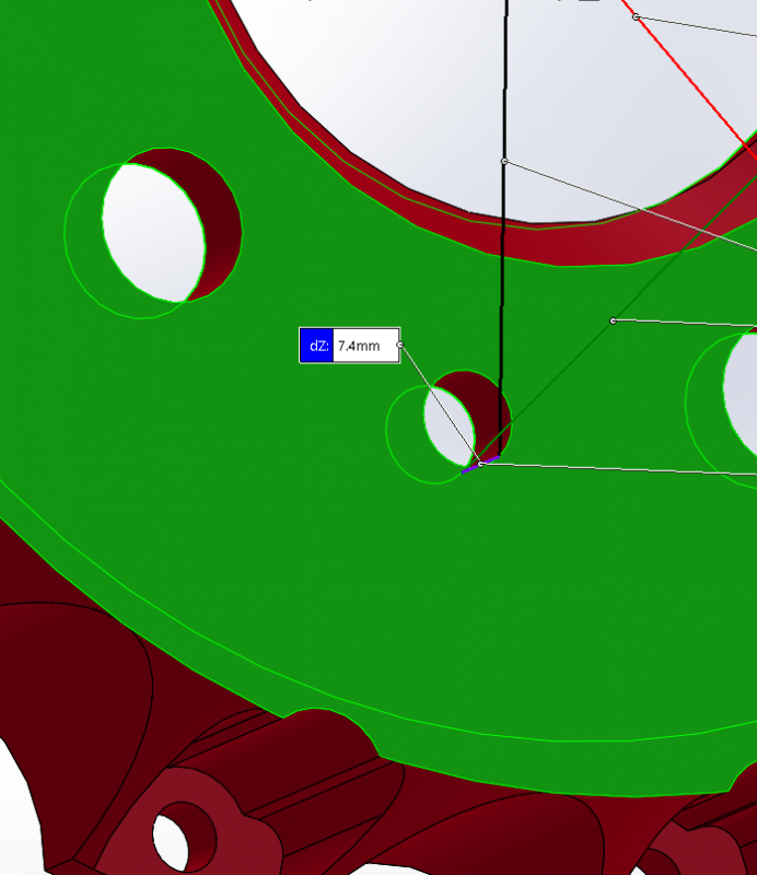

Thickness of the hats is 7.4mm, which I measured for both front and rear:
71596

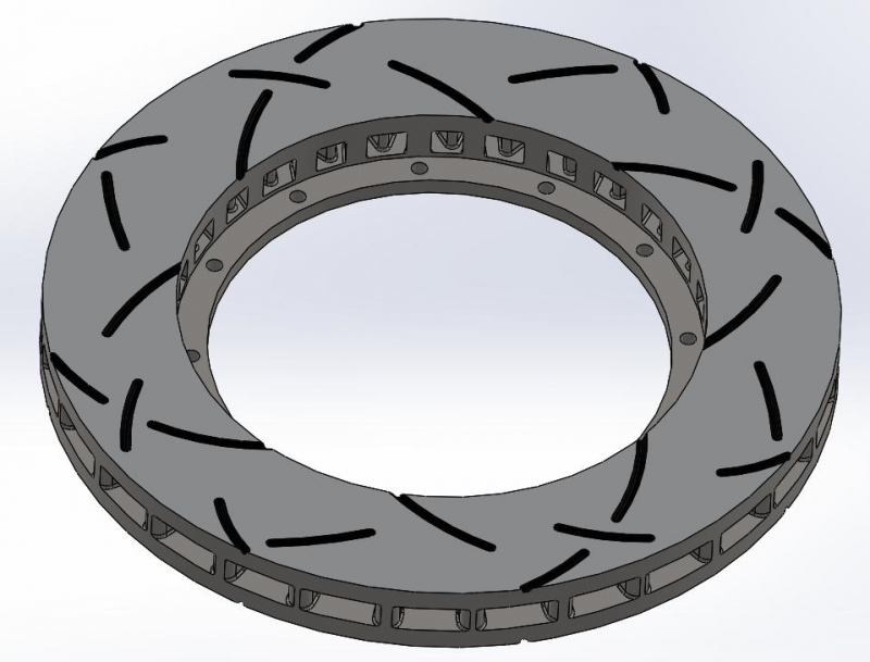

I needed to get creative with the rear rotor. The below solution was the best I was able to come up with, and it was only possible with the help from Chris. He verified that the maximum clearance in the rear rotor was 30.5mm, which gave me a half decent choice for the rotor. The difficulty in fitting a rear rotor was ridiculous. I spent maybe four days in total just going through catalogues!
This is the DBA52650.1, it is a 316x30mm rotor. As it is right now, the rotor won't fit. The maximum clearance for the rear caliper is 313mm, and the mounting lugs would
protrude into the handbrake. However, because I can fit the 30mm width, I don't need to play around with the caliper, and it is only slightly oversized.
71597
The solution is to turn down the outer edge by 6mm, and to turn out the original mounting lugs. I'll put 12 mounting points instead of 8 to better distribute the load, and I won't bother remaking the lugs as and just leave it solid.
71598
Shaving it down will just hit the pillars on the outside. On the inside there is enough of the original mounting lugs to use, but I need take off a bit more on the inner edge to allow clearances for tools to tighten the fasteners. Oddly enough the disk will be slightly stiffer this way as the mounting points are closer to the pillars.
71599

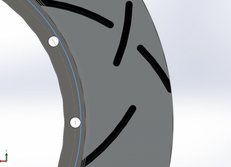

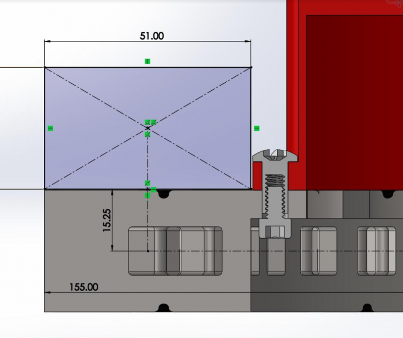

Chris also confirmed the area swept on the pad as 50mm. This is a critical dimension, if it was 55mm I would've needed to get creative with the mounting holes.
The blue line is a 50mm swept area:
71601
The blue line is a 55mm swept area:
71602

This is the whole assembly below:
71603

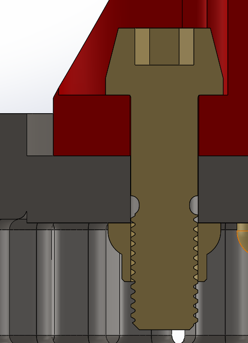

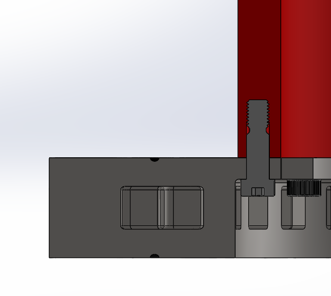

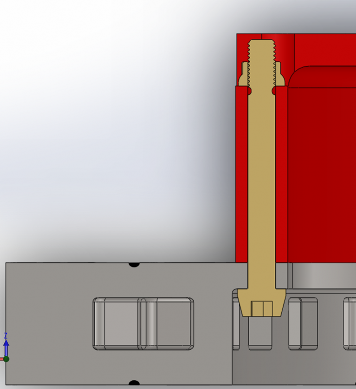

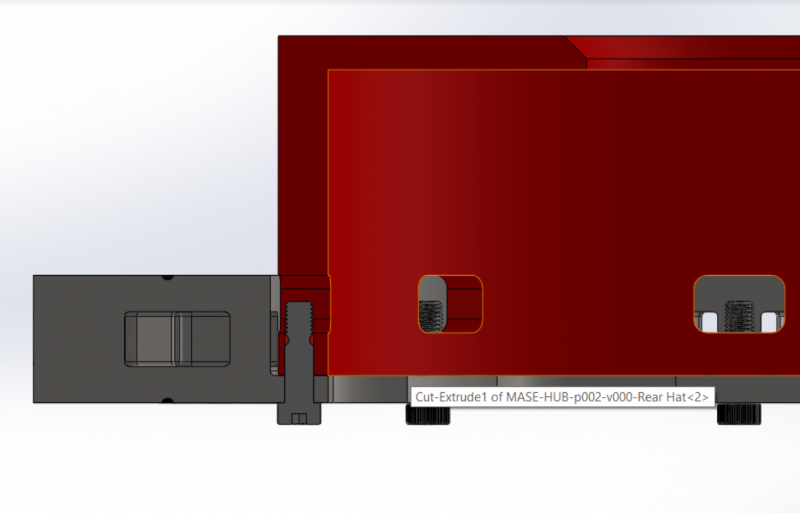

In order to mount the hat, the fasteners will need to come in from behind and tap directly into the hat:
71604

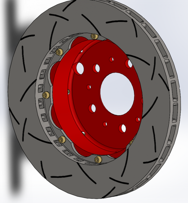

This transparent render shows how it will mount into the hat:
71605

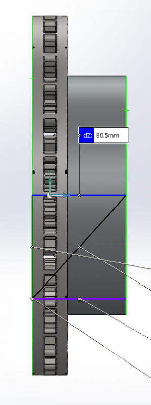

Total height of the assembly is the OEM 80.5mm
71606

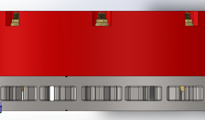

Here is a transparent render so you can see the pillar design, DBA refer to it as the 'Kangaroo Paw'.
71607

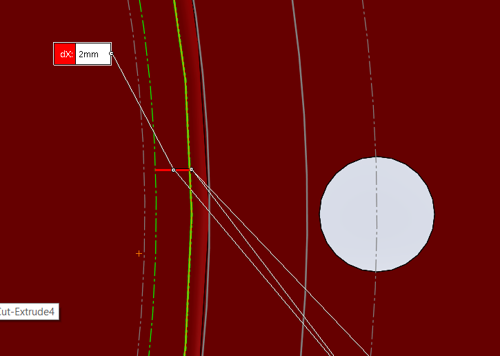

I also did some thermal expansion calcs on the rear rotor to ensure running oversized won't clash with the caliper. Being conservative, the 30mm rotor could expand to 30.2mm if it were to reach 600 degrees, which it never should.
Right now all the design work is done, just making a few little checks and changes. The last thing I need to do before getting my parts is select some appropriate fasteners as they will dictate the thickness and thread length of the mounting points.
I've also spoken with Hawk and they have a whole range of pads that will fit both the front and the rear of the car, and since they provide nice little temp charts, and just recently sent me their most up to date one, I'll select a set from them! Only AP Racing provides as much data, but none of their hardware was going to fit.

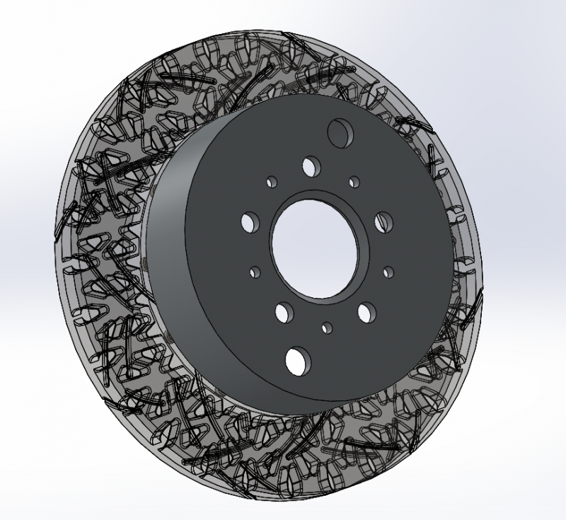

Front Rotor
71971
For the front rotor, the larger annulus meant I could only find two off the shelf rotors that would fit:
Willwood 150-15256
DBA5408.1R\L
As I've said previously, I went with DBA because of the ease of availability. DBA is a global company, with distributors around the world, so you would be able to get these rotors wherever you are.
USA
UK
Contacting them is quite productive and they will put you in contact with distributors. Locally the rotor costs $288AU and it is a directional vaned rotor with a slotted annulus. A thicker 34mm version of this rotor is used on the V8 Supercars.

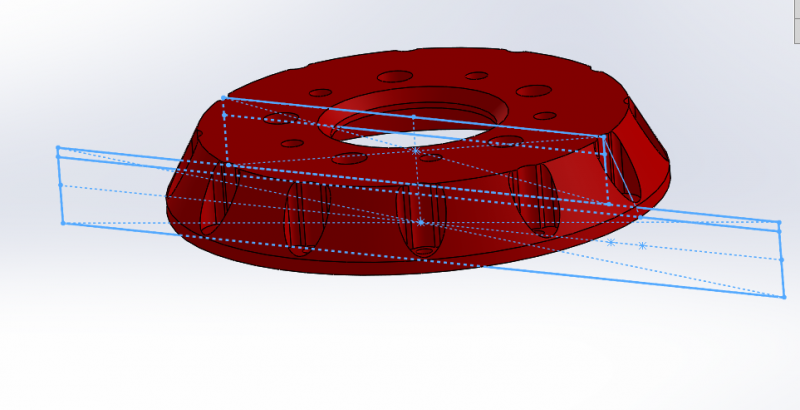

In order to get correct fitment in CAD, I measured up the original rotor - and with the help of google and other forum members - I created a profile for the height of the original components and drew the hat in those boundaries.
71973
In order not to clash with the hub, I also drew a reference sketch for the hub. I then drew several guide circles in order to ensure clearance. Fitment is quite snug with a clearance of 4mm (2mm per side) as I needed to make room for the bolt holes.
71974
71975
The inside diameter is 163.16mm, the rotor PCD (the diameter that the bolts run through for attaching the rotor to the hat) is 182mm. This means I have 9.42mm to fit the walls of the hat, and a 1/4" (6.4mm) bolt hole.
The solution was to slant chamfer the outer edge to provide as much rigidity as possible. I also needed to create a little cutout to accommodate the head of the bolt. There is <1mm clearance between the bolt head and the edge of the hat.
71976

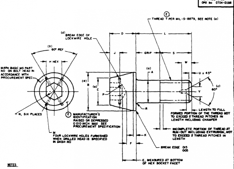

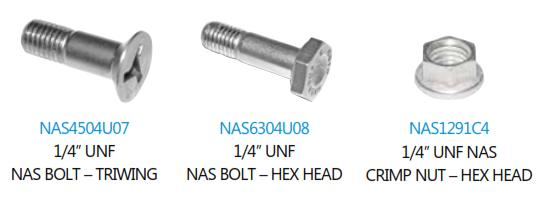

The bolts DBA use on their setups are NAS bolts. NAS is an aerospace product with yield strengths close to double 306 stainless bolt. The issue I had was that I can't use the hex head bolt due to fitment reasons, and with such a tight tolerance I had have precise parts. As I'm designing my own hats I also needed to make sure that I had the depth set correctly as the below are shoulder bolts. If I had the hole depth set incorrectly, then the nut would hit the grip (shoulder) before hitting the rotor and the assembly would be loose. I set about looking for drawings of the bolts so that I could set the correct thickness of the parts, which turned out to be very hard.
71977
You can see in the below cross-section that if I didn't have the thickness correct, the nut would hit the grip. If I had the bolt too shallow, there could be load from the rotor on the threads which is also bad.
71978
As I needed to select my own bolts, I ended up asking about the choice of thread (UNF instead of UNC), and it wasn't an arbitrary choice. The engineer said:
"They are UNF as the fine pitch is preferred due to its proof load and small lead angle. The crimp nut thread engagement on UNF enables a low profile body.
NAS bolts have a ground shank too.
So bolts. You want to drive the hat/rotor union on a bolt shank not the thread.

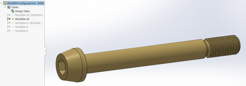

So I needed to look for a specific bolt. I eventually came across these guys AAE eStore | Aerospace Hardware and Supplies - AAE eStore who supply aerospace fasteners. They told me about Military Standards MIL-STD, Military specifications MIL SPEC where I could find drawings and technical requirements for every fastener you can imagine. After going through their catalogue I eventually came across a socket head cap screw that is MIL (military) spec that would be suitable. The series of bolts I settled on was MS20004. These bolts have a fixed 0.5" thread, and the rest of the bolt is shank. I then pulled up the current standard, which is from March 1989, and used it to accurately model the bolts so I could ensure the fitment. The document is a bunch of drawings and call outs. It takes a fair bit of back and forth to check the dimensions.
71979
71980
I fed some relevant information into a design table in my CAD program so I could 'test' fit several lengths.
71981
For the front rotor I will need 24 x MS20004-6 at $5ea. I'll use the crimp nuts that are supplied with the rotor as these are the correct thread.

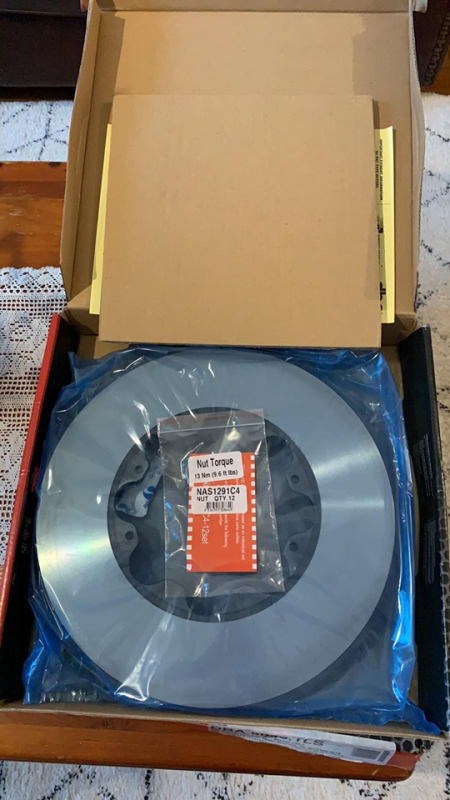

With the results correctly dimensioned I was able to get a quote on the part (and get it anodised red). $523USD for a pair out of 6061-T6.
71982
I'm really quite pleased with the front rotor - there are no compromises. This rotor isn't thinner, I don't need to go fiddling with brake pads or dog bones, and I get away from the issues and costs of other kits by quite a substantial margin. The cheapest front only kit I could find was ~$1600AUD before shipping. To equip the front setup as detailed above I'm looking at $1448AUD including shipping.
Rear Rotor
The rear rotor was just the biggest pain, and it was made harder as it wasn't until I found a supplier for the MIL spec bolts that I had a way forward. Before that I was using McMaster Carr as all their bolts come with drawings and CAD files, but they didn't have anything quite the right dimensions. More on that in a bit.
71983
I found several rotors that were good candidates, but everything was a compromise. None of the rotors were the correct dimension in every direction.
The closest I could find was by Alcon DIV2235X562C48. This would probably be a decent matched rotor for Zep's kit as it is a racing fish hook design with direction vanes. However, I decided not to go with it as I didn't like the position of the mounting lugs. Ultimately I went for a rotor that was oversized in every direction so that I knew I would have enough material to remove and get a correct fit. I settled with the DBA52650.1. This is a bi-directional pillar rotor used on a number of Subarus. It is a 316x30mm rotor, has a massive annulus and lots of material in the centre for mounting. Due to the changes I would need to make, I spoke with the engineer who designed this specific rotor to find out the minimum thicknesses, and consequences of any changes. Because this rotor is so thick and heavy it turns out that the minimum thickness for the rotor would be ~25mm, so taking this rotor down from 30mm to 28mm for my application would be acceptable. These rotors are $667AUD a pair, and machining will be another $100 per rotor.
Before:
71984
After
71985
The real trouble came with clearing the handbrake. For whatever reason, even the handbrake is oversized. I tried about a dozen variations of the rear hat until I found the MIL spec bolts.
I thought about tapping into the hat directly, but the engineer advised against it:
71986
I thought about mounting from the other side and using little windows to fit the nuts. The problem with this was that it blocked off the ventilation. I couldn't do this from the top as the little holes would conflict with the handbrake surface. The idea itself isn't that cray, Wilwood use it on some products.
71987
71988
The handbrake interface inside the hat:
71989
I tried to make a conventional flange fit and used some clever low profile fasteners, but there was no way it wouldn't clash with the calliper.
71990
71991
488 Posts
Discussion Starter #14
The gap between the calliper and hat is only 8mm!
71992
I tried the inverted mount again, but this time with ventilation cut into it. This would've worked but the machining costs would've piled up....
71993
When I finally found the MIL spec bolts, I was able to come up with a much more appropriate design. I ran the long bolts all the way to the top of the hat, taking off only enough material to allow the nuts to fit. This meant that my costs were reduced slightly as I could use the supplied nuts with the rotor. It also meant that I could keep the shank as the only interface with the hat and not the threads, there is no risk of the threads pulling out of the hat, and because I had accurate drawings of the bolts I could ensure there are no clashes or interference.
71995
71996
71997
Everything is unbelievably snug and it wouldn't have been practical do this conventionally, too many expensive mistakes to make! Being able to test fit parts in CAD has made this viable for me to do. I don't have a current quote for the rear hat, but the last one I had was $600USD. I'm expecting this one to be similar, if not slightly less as it is simpler. So I would have 16 x $5 for the bolts, $863 for the hats and $887 for the rotors. So $1810 for the rears.

I went around to the car to test fit my parts, and it went well! I've made a few notes for design revisions in the future, but everything fitted as expected.
This photo shows how overworn my OEM rotors are
132653
Here is the OEM compared to my 2-piece
132654
Now here is the big question, does my solution for the handbrake work? Yes! It does! @MAS430 was a big part in this, he emailed me from the other side of the country to help validate all the measurements sot that this solution wouldn't contact the caliper!
132655
There is somewhere around 2-3mm of clearance, so more than enough!
132656
The larger access holes for the handbrake made things a lot easier to adjust.

I haven't had a chance to weigh them yet, but from the CAD the mass should approximately be:
Front - 11.9kg vs 10.5kg
Rear - 9.9kg vs 7.5kg
All the mass savings should be in the hats as they're 6061-T6. I have picked rotors with thick contact surfaces and a thinner airgap than OEM to increase their overall thermal capacity. Once of the things I learnt during this process (and I learnt this directly from an engineer who holds patents in brake designs) is that all the marketing around 'better cooling' is fictional. Unless you're heat soaking the rotor entirely (in which case you have other problems) most of the heat is in the contact patch and is dissipated through radiation (why they glow red) rather than convection (air flow). That said, there is a modest weight saving overall in the system

Front Revision:
  • Increased the chamfer on the top outer edge to prevent chipping of the anodising.
  • Cosmetic change with the thickness of the outer edge with how it matches with the rotor.
132780
