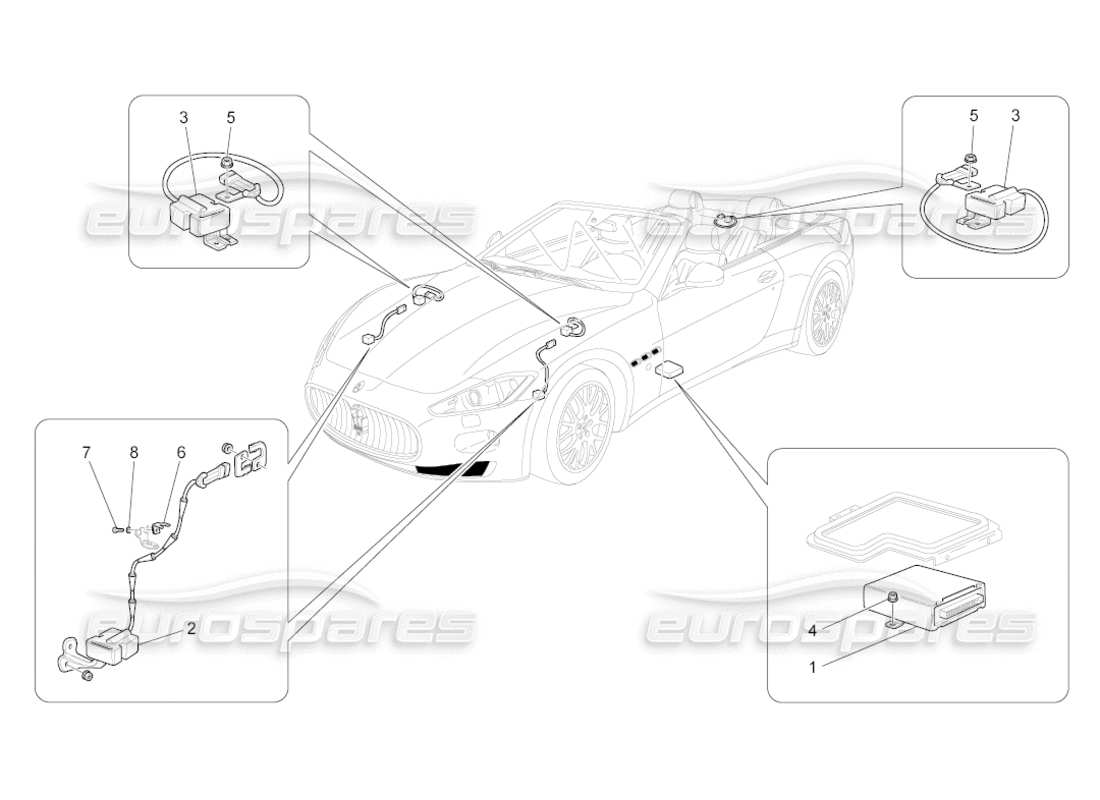

This was my part # 290747 (Suspension control unit) maybe yours having a different code and price

But the part number he listed is a control unit that sits on top of the shock not the shock ECU
If i understod you wright you are refering to the WHEEL ACCELERATION SENSOR, that part have nothing to do with this susspention control and it is the cause of the error.

part number 290747 is what I linked to
It is under the drivers legs and it is the correct one and the cause of the problem, What error code u have
