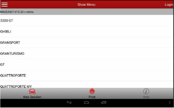

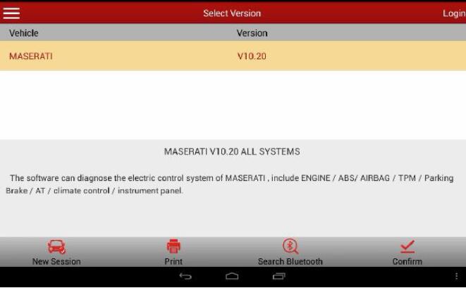

2.Select Europe;
3.Select the Maserati V10.03;

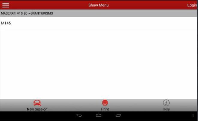

4.Select the GRANTURISMO model;

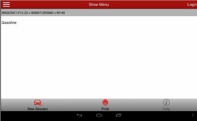

5.Select the M145;

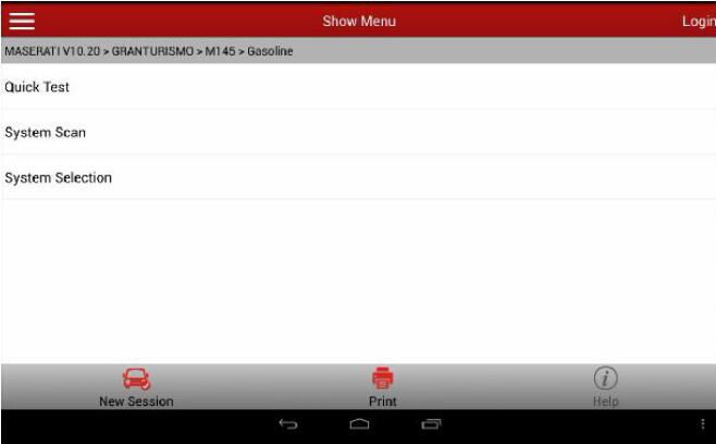

6.Select the Gasoline;

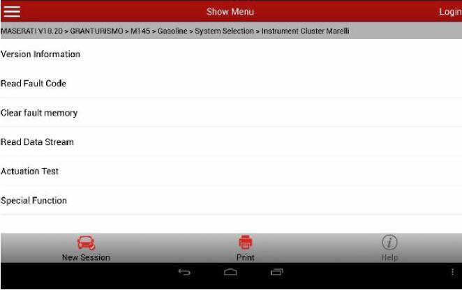

7.Select the System Scan;

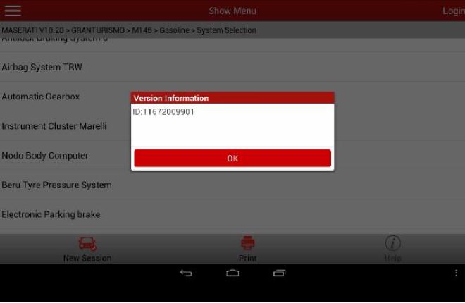

8.Select the Marelli Instrument Cluster;
9.Read out the ECU ID, and select Confirm;

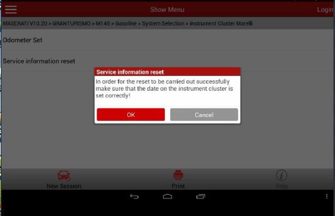

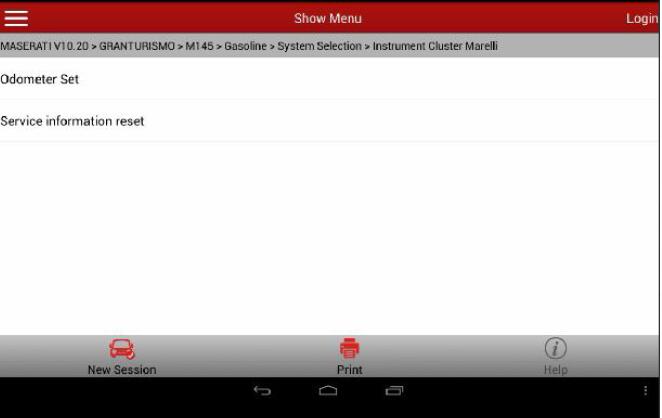

10.Select the Special Function;
11.Select the Service Info Reset;
12.Pay attention to the reset service hints to ensure the date on the instrument cluster is set correctly;

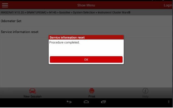

13.After confirmed, it indicates “Procedure completed”, then the operation ended.
