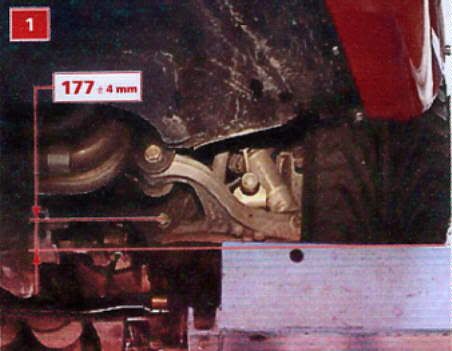

The part of the suspension becoming much softer is what worries me a bit, our roads are nowhere near as good as yours and the "pediatrician" :D tells me that I could be rubbing my belly from time to time and very sensitive parts like the control for the Cambiocorsa could be in grave danger.
Factory specs for model year 2004 - 2005 are:
Front 177 mm within +/- 4mm
Rear 188 mm within +/- 5mm
meassurements must be taken with a full tank of gas and 160 lbs. on each of the two front seats
I wonder what would be the result if I cut one or two loop on the springs... have you heard of anybody giving that a try...???
