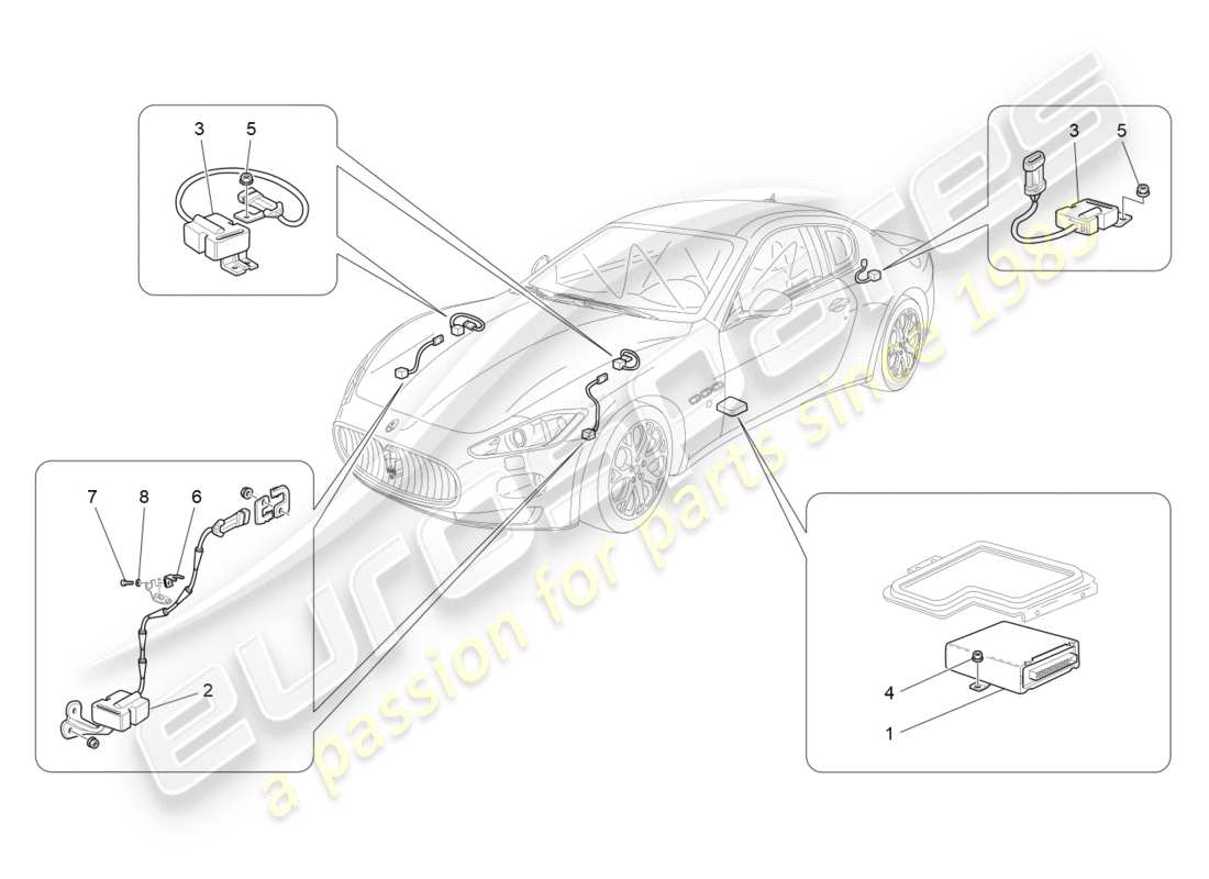

Hi, could someone please show me where the suspension sensors are for the 2004 coupe? I think mine might be dirty. Thank you!

They're accelerometers so dirty is not really a thing. You probably need to get the codes read to see what's really happening.
Locations are on the Scuderia / Eurospares parts diagram.

I've not been able to find them on the 4200 diagrams, but this might help.
